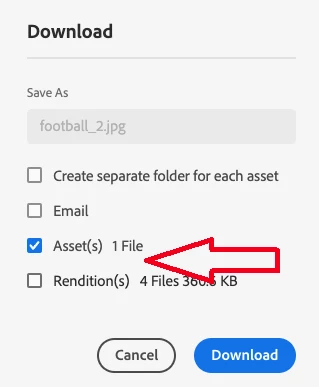

We have a requiremet to display a text value inside the Download dialog pop up(when we click the download button on an asset)
The text value which need to display inside the download dialog is stored inside metdata schema with i.e dam:xyz property and this value need to be retrived and it should display inside the download dialog.
please help me to solve above requirement.

You would need to overlay this file: /libs/dam/gui/coral/components/admin/downloadasset/clientlibs/downloadasset/downloadasset.js and add the logic to include the extra information you need. Alternatively, you could create a custom JavaScript script to inject into this popup and display the extra info.

Thank you for the reply @estebanbustamante It will me more helpful, if you can share the code snippet or a link with the similar kind of use case
