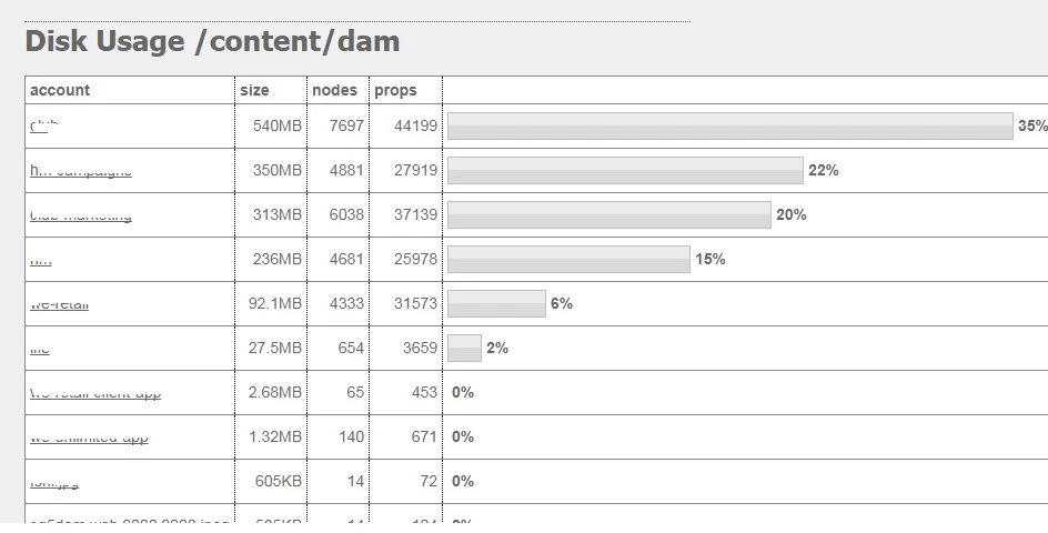

I wondered if somebody can please help me or point me in the right direction.  Sorry, I have searched the forum, but maybe not using the correct term.  We are using the AEM DAM, and I would just like a report on how much space we are using and if possible how much space we have.

Best answer by BrijeshYadav
You can get dam report here.
localhost:4502/etc/reports/diskusage.html?path=/content/dam
/Brijesh Yadav

davenichols79
October 13, 2017
Hi Yadav,
Thank you very much for this - it was exactly what I was after and helps a lot.  Thank you.
