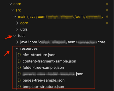

2. You can create a "resources" folder under your test folder, something similar to this:
This will be available in your classPath if you use context().load() https://wcm.io/testing/aem-mock/usage-content-loader-builder.html, otherwise you can check this: https://stackoverflow.com/questions/28673651/how-to-get-the-path-of-src-test-resources-directory-in-...
