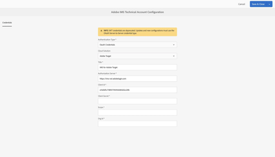

@AkshaySwamiii The details for OAuth should be present in the new configuration you created as part of the migration process in the Adobe Developer Console[1]. From there, you can retrieve those values and set up the new IMS configuration.
Once that is done, you need to use this newly created IMS configuration with your "Target Cloud Service" configuration[2]—that’s all.

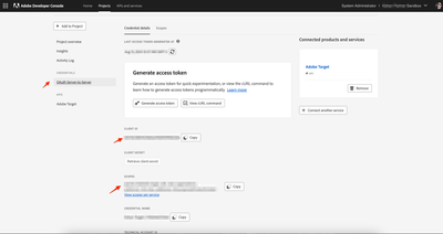

yes, like i have added an equivalent OAuth Server-to-Server credential, then how to use cURL command when there is already a token and cURL command which is used by jwt and that is not editable ?

On its point-6, I am getting confused like from where we get the details to fill for oAuth,  when in developer console there are details of jwt token only.
On the Dev Console, navigate to the OAuth Server-to-Server credential page. They contain the details you need to copy over.

Hi @EstebanBustamante,
Now, I have one confusion after creating similar oAuth credentials, I found that for both jwt and oAuth the information are same.
So, can I use this detail to fill Cloud Services -> Target Config ?
Yes. Also in your screenshot I can see your client secret. Please rotate it as soon as you complete the migration.
