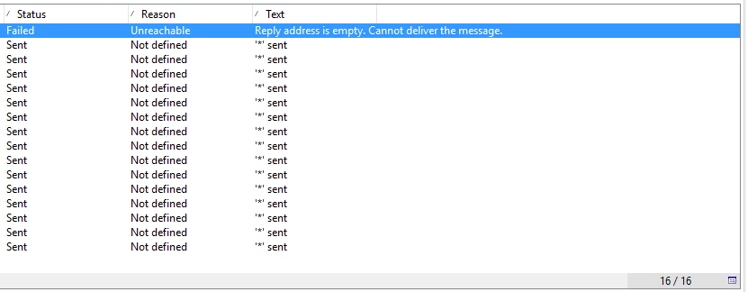

I have something rare with some deliveries, for example this delivery :
The emails to send is 16, but processed number is 20 and succes is 19, which is completely wrong, after getting inside the delivery log i notice that the number of processed should be 16 and succes should be 15 :

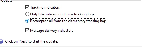

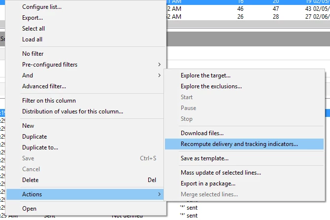

But, after i do a recompute of the delivery, using the "recompute all from the elementary tracking logs":
the datas come back to normal.
