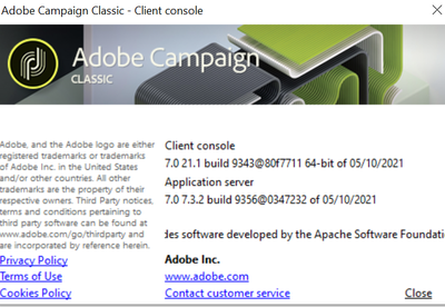

Find the SS below for the build which I am using now:
Hi @DhanushGM1 ,
As per the client console details you have shared, your console build is not updated to 9356. Could you Please update your Client console and try the same . You will be given a URL to download the Software( ZIP File) and then you can install the latest version and try the same.
