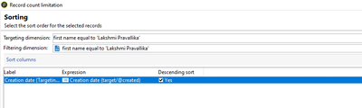

Next, Please use the Split activity to get the recent record based on creation date with Configuration shown below:
Please select "Keep only first records after sorting" option and define the descending sort as shown below

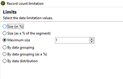

in the Next window, you can select maximum size as 1 record to get the latest one.
