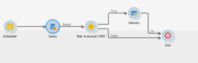

it seems you need to make your own workaround. What comes to my mind is to create simple check after sheduler to check if it's 3pm and if not simple will stop workflow and scheduler will fire next time.
As an possible workaround for the problem:
Marcel

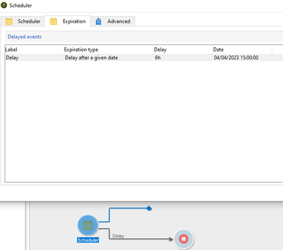

Perhaps you can use the expiration feature in your Scheduler to delay execution during your chosen date.
Marcel

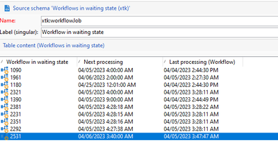

i have checked my local instance, scheduled worklfow and shut down the server. Indeed it will process the workflow even after the scheduler date is already in the past.
It looks to me it works followingly:
The workflow server process (wfserver) looks (somehow its black box to us) to  xtkworkflowjob table, you can see it also from the rich client under the shemas - xtk:workflowJob. The "process" checks the column tsnextprocessing (Nex processing) and if the timestamp in here is less or equal to the column tsprocess (this is in console under xtk:workflow workflow/@process) the workflow will trigger. Ofcource the workflow has to be in state started.
