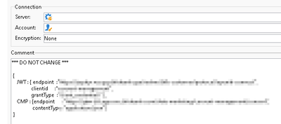

I am performing some tests, I have in an external account in the comment section some configuration in object literal
    JWT : { endpoint  :"https://somelink1",
               clientid     :"consent-management",
               grantType  :"client_credentials" },
    CMP : {endpoint      :"https://someotherlink2",
                contentType :"application/json"}
In a workflow I am loading the external account object and matching object configuration in the comment section using a regex, while I can JSON parse it, I cannot seem to navigate using dot notation.
var auth    = nms.extAccount.load(39010);
var regex   = /{([^;]*)}/gm;
var authObj = JSON.parse(JSON.stringify(auth.comment.match(regex)));
logInfo(authObj);
Normally I would then navigate using dot notation (authObj.JWT.endpoint) but I am getting undefined.

Hi o_X,
there are two issues with your approach:
1. code is wrong. Look at this line:
the "match" method returns an array of found matches (in your case 1), like this:
[{     JWT : { endpoint  :"https://somelink1",                clientid     :"consent-management",                grantType  :"client_credentials" },     CMP : {endpoint      :"https://someotherlink2",                 contentType :"application/json"} }]
 Then your performing a stringify on that Array, which results in this
"["{\u000a    JWT : { endpoint  :\"https://somelink1\",\u000a               clientid     :\"consent-management\",\u000a               grantType  :\"client_credentials\" },\u000a    CMP : {endpoint      :\"https://someotherlink2\",\u000a                contentType :\"application/json\"}\u000a}"]"
Then your JSON.parsing that thing and you again get the same array as the result from the first step.
Instead you should modify you code to this (no JSON stringify needed and you access the first found match):
var auth    = nms.extAccount.load(28470478);
var matches = auth.comment.match(regex); // returns array
var authObj = JSON.parse(matches[0]); // access first match and remove JSON.stringify
logInfo('authObj.JWT.endpoint: ' + authObj.JWT.endpoint);
logInfo('authObj.CMP.contentType: ' + authObj.CMP.contentType);
2. problem: the JSON in the external account's comment is invalid and the parser isn't able to parse it. You noted:
Instead you need to add double quotes around the keys and remove the spaces between the key and the colon:
  "JWT": {
    "endpoint": "https://somelink1",
    "clientid": "consent-management",
    "grantType": "client_credentials"
  "CMP": {
    "endpoint": "https://someotherlink2",
    "contentType": "application/json"
 Best regards, Tobias

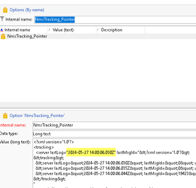

In the case of geting a string from platform options, how do you get the timestamp of lastLog
I've tried
var data    = getOption("NmsTracking_Pointer");
var doc     = new DOMDocument.fromXMLString(data)
logInfo(doc.root.getElementsByTagName('lastLog')[0])
Hello @o_X,
i've had the same need in the past, here is how i did it :
//Get lastLog Date from NmsTracking_Pointer option
var trackingOption = getOption('NmsTracking_Pointer');
var trackingOptionXML = new XML (trackingOption.replace("<?xml version='1.0'?>",""));
var dateLastLog = parseTimeStamp(trackingOptionXML.server.@lastLog);
Br,
