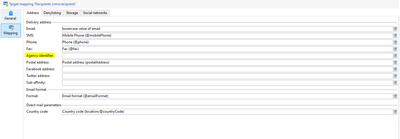

Hi @ShineVv0823 ,
Could you Please try mapping the mobile phone number field to the Agency Identifier field in the Target Mapping and try sending the delivery.
If this don't work, it can be tried by adding it in the Additional Data of Target Mapping, the required field to be populated

Hi @LakshmiPravallika ,
Thank you for your help.
Tried with the first approach (mobile phone number field to the Agency Identifier field), we had the same issue the new channel delivery is not picking up the address field as mobilePhone.
The second approach we added the additional field in the target mapping, but all channel deliveries are failing with the below error. not sure if we have missed out on something and so we removed the field in the target mapping.
The whatsApp connector JS is working fine we choose the external account as SMS and choose the connector JS as whatsApp connector. we are able to send and recieve whatsApp messages.
the detailed error logs and target mapping screenshot is below
13/10/2023 09:54:48 XSV-350122 An error occurred and the process has been stopped.
13/10/2023 09:54:48 SOP-330011 Error while executing the method 'PrepareMessageImpl' of service 'nms:delivery'.
13/10/2023 09:54:48 (0, 127)' could not be executed.
13/10/2023 09:54:48 WDB-200001 SQL statement 'INSERT INTO NmsBroadLogRcp (iBroadLogId, iDeliveryId, sAddress, iStatus, iFlags, tsEvent, tsLastModified, iMsgId, sAddress,iRecipientId) SELECT BL.iMessageId, 587651, BL.sAddress, CASE WHEN BL.iFailureReason = 0 THEN 6 ELSE 0 END, CASE WHEN BL.iFailureReason = 127 THEN 8 WHEN BL.sTargetCode = E'__MAIN__' THEN 0 WHEN BL.sTargetCode = E'__BAT__' THEN 2 ELSE 4 END, GetDate(), GetDate(), BL.iMsgId, BL.sAddress,BL.iRecipientId FROM wkDlv_587651 BL WHERE BL.iFailureReason IN
13/10/2023 09:54:48 PGS-220000 PostgreSQL error: ERROR: column "saddress" specified more than once LINE 1: ...iStatus, iFlags, tsEvent, tsLastModified, iMsgId, sAddress,i...
