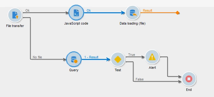

Best answer by ParthaSarathy
Hi @shruti1 ,
You can also try below approach,
Connect a JavaScript Code activity in 'Ok' transition of file transfer, and enter the below script inside JS code activity
logInfo("File Processed")
'No file' Transition:
Query:
Targeting & Filtering Dimension: xtk:workflow
Filtering Condition:
@internalName equal to internal_name_of_current_workflow
AND
Message (log)   do not exist such as
        @message    equal to    File Processed
         AND
        @logDate      equal to    SubHours(GetDate() , 5)

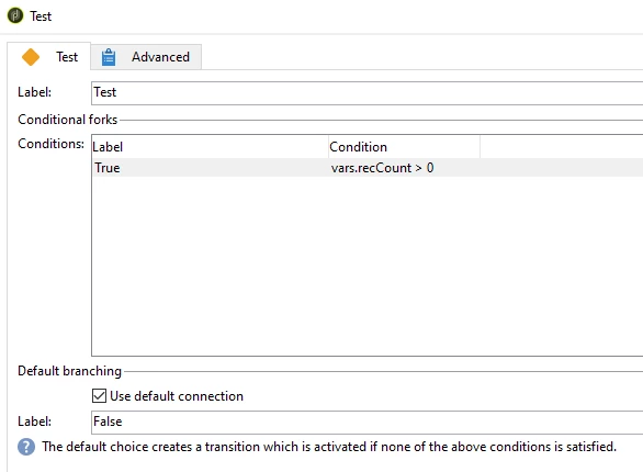

Test Activity:
vars.recCount > 0
And configure the Alert activity.
Now when there is file present, 'File Processed' log will get generated. If there is no file processed in last 5 hours, an Alert will get triggered.

ParthaSarathyCommunity AdvisorAccepted solution
February 2, 2024
Hi @shruti1 ,
Query:
AND
         AND
Test Activity:
vars.recCount > 0
