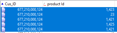

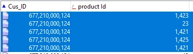

I'm trying to get the product most ordered by a customer based on the below table:
What I'm trying to achieve is to get a final table with Cus_ID | Most ordered
Ex with the above:
677210000124 |  1,421
The main table is the Recipient table and the other table is linked via a "one to many" link.
What should I do to get to this outcome?

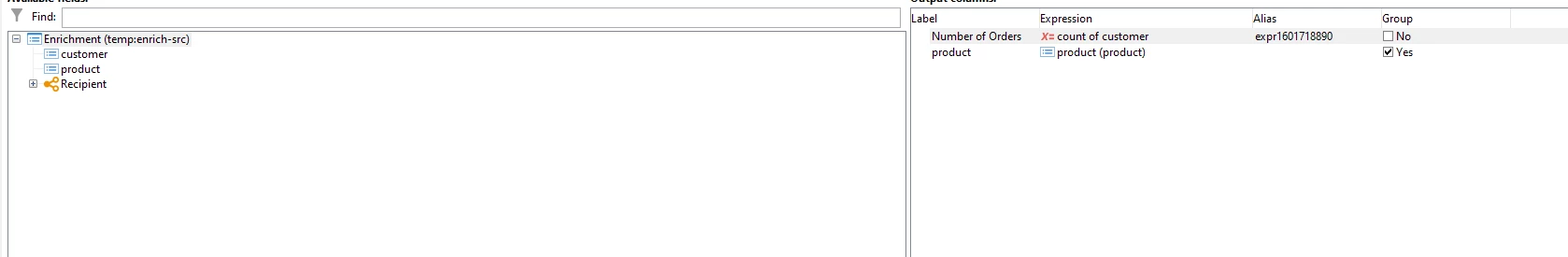

You can query all your data from this orders schema and then add an enrichment after this.
In the enrichment add these two columns product id and the customer Id. Check the checkbox which says groupBy for product id column and then in the recipient column
Something like this

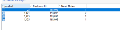

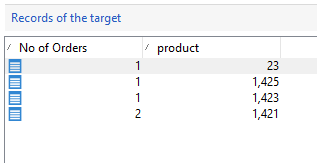

Then after running the query you will get the output where you will have the total number of orders against a product like this:
Then you can again enrich this data on the basis of product id with the original table to get the desired output. I have added an additional column of no orders.
Let me know if that helps.

Hello @oliviergroux ,
Something like this
