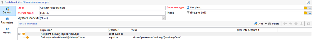

This is an example of a simplier filter (the one I built is more complex) I want to apply in the wkf:
As you said I cannot use it on the target audience before the delivery is prepared and that's why I have inserted it in typology. Therefore I would love to be able to get an estimate of the target audience through a test-run of the wkf.
Usually we have these filters in all the workflows as a split. The problem is that we need to adjust those manually and I thought it would be great to retrieve data automatically from the delivery properties of the delivery linked/connected to the workflow.
But I get what you are saying, the customers are not in the delivery-stage yet and as I understod I unfortunately cannot exclude those customers based on future events.
Hi @A_B_SE
True you can't use the rules you did in the typology rule as is, I never said you would. The pre-defined filter will be slightly different and you will have to type the delivery code itself.
