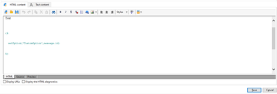

Hello @balakrishnavalavala  Where are you using this setOption code?

    Thank you so much for the quick reply. We are using the set option as below in email delivery's HTML Content.

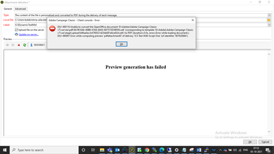

    When we try to use the pdf functionality, we are getting below error from from preview.

    Thank you so much for the response. The main functionality here is, we are looking to send the personalized dynamic content of each recipient as an attachment in the email. Here we have tried .odt functionality (The content of of the file is personalized and converted to pdf during the delivery of each message) but it is throwing above attached error and also we are not looking the PDF format as attachment. To overcome this, I have a thought to set the option dynamically like above and get it in a custom JSSP page and then attach that content of the JSSP as an attachment in email delivery.

For question 1: setOption() is unavailable in delivery content, per the error message you get when attempting it.
