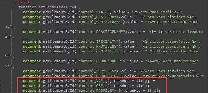

Upon reviewing everything, the data is being stored properly when I change the type from checkbox to text, so I think it is about the way I am saving the checkbox data.

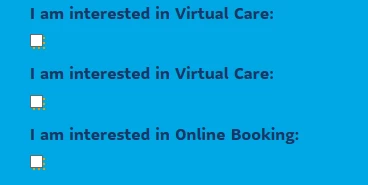

(picture below should have a row under language for Online Booking, and it does not.)

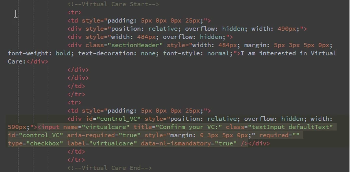

I am creating my first web app landing page in ACC and while I have all of my text input fields working, I am struggling to get the checkboxes to relay the data I want.
In the HTML, I have set the values - if checked - to be = 1

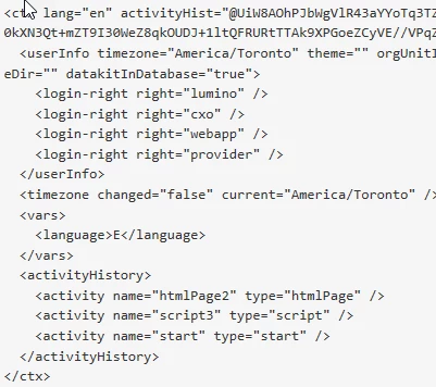

I was also looking into a data transfer issue, but the variables used in the web app, the HTML and data schema all line up:
Any help would be greatly appreciated.
