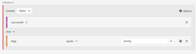

Thank you and I appreciate both versions of feedback - But is "Hit" really the scope that I'm after if I'm looking for people who have never visited a pricing page? I would assume excluding at the visitor level means that it would exclude all people who have ever had the pricing page in their cookie history.
Ahh.. ok... sorry, Visitors who have never visited a pricing pages is different.. and are you looking for "never ever", or "not in the last x days/x months/whatever)?
In that case, you do want visitors, but you actually have to use an Exclude rule to make this work.
So you can build a segment like so:
Or if it must be in a time frame, let's use "Last Month" for an example:
^ So I am looking to exclude the specific page (or pages) within a specific time frame
Basically, a visitor may have made a purchase a few years ago, but hasn't recently would still be eligible to be returned by the segment.
When dealing with Visits and Visitors... "does not contain" works very differently than "exclude"... whereas on Hits they are pretty much interchangeable....
