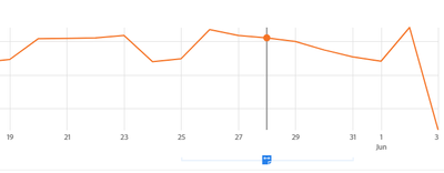

I've noticed that the x-axis labels on my chart aren't accurately reflecting the chosen date range for the visualization. This is impacting my ability to interpret the data correctly. Could you help me understand why this might be occurring and how to resolve it?

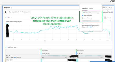

Hi @SunilaAd1
I think its because the link chart is locked, can you uncheck as shown in the below image and try?
If this is un-checked, the chart will automatically adjusted to the selected date range. Let me know if its not working.

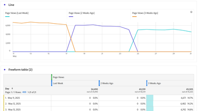

Yes, as Mandy said, using date ranges in the table natively will result in Adobe trying to slot them as "comparative periods"...
However, if you create segments, you can have the data appear as a progressive line (I used Last Week, 2 Weeks Ago, and 3 Weeks Ago as examples):
Setting these segments up as columns, you can graph like this:

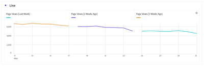

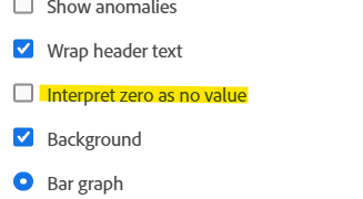

If you don't like the drop X pattern during the crossover, you can set your data to "Interpret zero as no value"
Which will result in this:
Still not quite ideal, since now you have some gaps between the days....

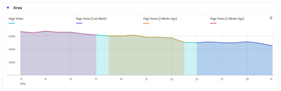

But, if you add another, unsegmented column over the full range, you can sort of hide those holes:
You can even use an Area chart to make each period more visible:
Those gaps will appear a lot smaller when you are dealing with longer periods of time (like you are)
