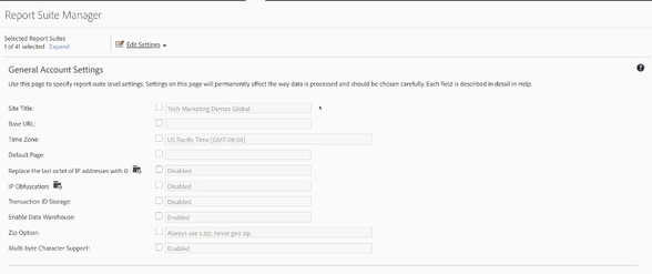

@skatofiabah Data feeds honor the time zone for which the report suite is configured. So it will be the same time zone as your report suite time zone. Which you can find in General Account Settings in Report Suite Manager.
Time zone of the report suite can be found under
Admin > Report Suites > Select report suite > Edit Settings > General > General Account Settings.
