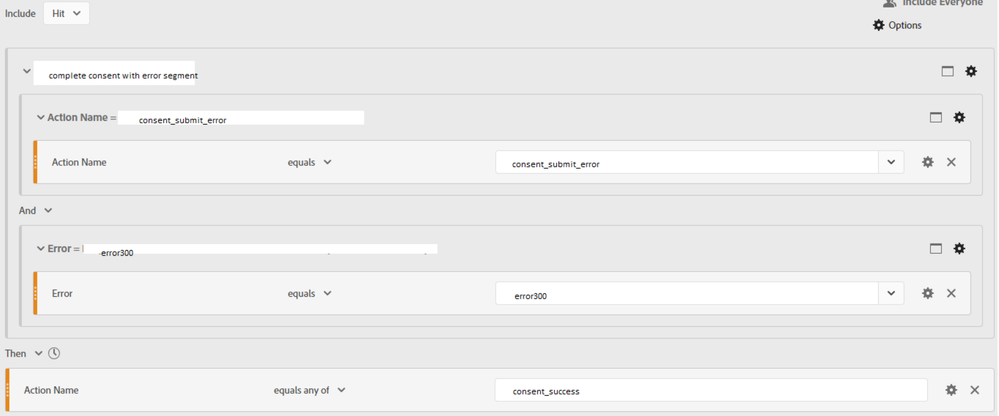

For the second flow, I made the segment as follows:
Here I get 0 visits and visitors, even If I change it to "Visits" at the top.
I suppose it is possible that no one has made it to a 'success' at this stage, but is my line of thinking correct here?

In the first segment:
This is looking for any specific hit that has both "consent_submit_errorand "error300" both values must be on the same hit.
In the second segment, you are looking for Visits that have any hit that has "consent_submit_error" and any other hit that has "error300", these don't have to be on the same hit... so you are pulling back other combinations, like hits that have "consent_submit_error" with "error350" and some other error message with "error300"
If you need to pull a Visit level segment (i.e. pulling back all the hits of a visit, where there is a specific hit) then you need to add a Hit level container inside the Visit level segment explicitly looking for hits that have the combination of the two values... such as:
VISIT [
    HIT container [
        Action Name equals consent_submit_error
        AND
        Error equals error300
^ This will pull back all hits in a visit (segment scope), but the logic is still looking for the explicit combination of content_submit_error with error code error300 (hit scope).
So now, if you need to combine this into a sequential segment, first, this must be at a Visit or Visitor level to make use of the THEN logic (you cannot use then on a hit because the logic looks at each hit individually, so on a single hit, the value cannot be one value and then another).
But I can see that you have a proper HIT level container around the first clause (combining the error message and value), and then you have your success. The only issue I see is the use of HIT at the segment level, but you did mention that you tried Visit which should work.... Are you sure that people are actually completing this flow in the same Visit? If you have an isolated QA / Dev suite, can you try to replicate the flow so you know you have at least 1 success, then wait for the data to process and test your segment against that test environment?
