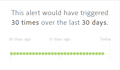

joew38481565
August 21, 2018
I added the 'or' statement so I could have a filter for each weekday (partial screenshot below).   The counter in the top corner says that the alert would have been triggered 30 times in the last 30 days.  When I looked at the actual daily visits the only days where the the visits were less than 100 were on the weekends...so it really shouldn't have been triggered at all over that last 30 days.  Not sure why this would be.

joew38481565
August 21, 2018
I created another segment based on hits for the targeted pages but the preview still says the alert would fire every day (30 times over the last 30 days).  When I remove the day filters then the preview says it would fire on 9 days out of the last 30 which is correct since there were 9 weekend days where daily visits were below 100.   However, I'd rather just have the alert based on weekdays so I wouldn't be getting alerts sent to me every week because of expected lower Saturday and Sunday traffic.

joew38481565
August 21, 2018
I created a segment that filters out the weekend days.  Still didn't work....seems like there is no linkage between the metrics trigger and the additional dimension/segments filters.   Strange....the only thing that adjusted the alert getting triggered in the preview was adjusting the metrics trigger number (either up or down).   Adding dimensions/segment filters (like day of the week) didn't seem to result in what you would expect.  It actually added more days where the alert trigger would fire.

joew38481565
August 21, 2018
I changed the trigger metric to pageviews (< 500) which correctly identified 9 days (weekend days) where the alert would get triggered.  However, when I added the day of the week filter (for Monday), the preview stated that the alert would get triggered 25 times over 30 days.   It looks like the day of the week dimension filter works differently than expected.  Really bizarre.....setting up a simple alert shouldn't be this difficult.
