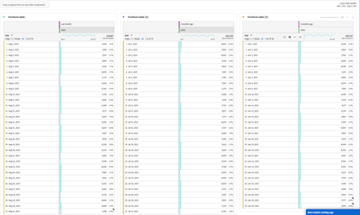

I've scheduled a daily report on rolling dates but data of the latest days would be hidden if I did not manually expand the component once in a while. Is there a way to have this done automatically? Thanks!
This is because the FreeForm size stays the same as last saved project which is the layout that gets rendered while generating the scheduled output.

@VaniBhemarasetty Thanks for your response. However, in our case, we are using the rolling dates function to monitor daily visits & visit trend of our campaigns, which is the reason we are having Adobe Analytics schedule-send a daily visit report PDF to our colleagues. The issue here is that, even if we left space for 10 rows of data in a component/chart/campaign first day of launch, for example, we'll have to come back once in a while to manually expand each component because when there are 15 rows of data the component will not automatically expand itself to display the 11-15th rows but gives you a scrollbar. The 11-15th rows, nevertheless, will not be displayed in the daily visit report PDF as you can't use a scrollbar in a PDF.
Moreover, since our campaigns usually last around 3 months and at the end there will be at least 90 rows of data per component. We'll have to manually expand the components for multiple times during when the campaigns are up and running.

Solution 2 didn't work for us as there would be too much blank space shown in the report PDF especially during first half of the campaign, but would definitely try out solution 3 which sounds brilliant. Really appreciate the help and thanks again!
@kittychangThanks for writing in. I have heard of this behavior earlier too. What happens when you try scheduling the report by selecting all 400 rows, by default?
@Ishan_Sinha_ We selected all 400 rows for all charts but the problem was still not solved. So I think the reason is, as @suneeshkachroo suggested above, "FreeForm size stays the same as last saved project which is the layout that gets rendered while generating the scheduled output."
