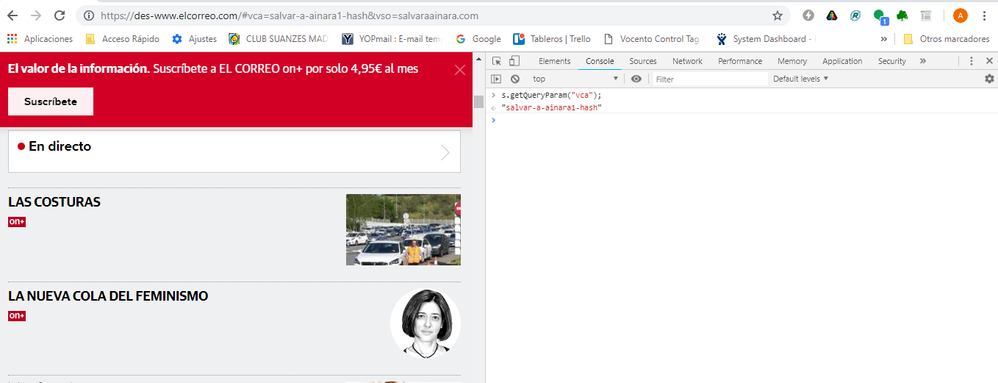

Hello Alexis.
I hope this message finds you well. We went ahead to create our own plugin which I placed under the plugin seccion of appMeasurement and commented the official getQueryParams 2.3. in order to avoid any possible conflict.
First of we call it vocQueryParams but eventhough it was working fine on the browser console, it did not work when tried to use it through processing rules. Next I changed the name of the plugin to be the same one as the official plugin (as you can see in the screenshot) hoping that will make the getQueryParams (ours) available from the processing rule interface. But that didn't work either.
What are we missing? Because from the plugin point of view, it works just fine. This is doing my head in
I already asked clientCare to no avail so I though perhaps you could shed some light into this matter.
Thanks ever so much for all your help!!
Hi
I do not know what you mean by processing rules interface. The only processing rules that I know are the one you can set in Adobe Analytics Admin interface to add an additional level of processing once the data has been sent.
Processing Rules
Using this processing rules does not require any addiitonal javascript code.
In your case if you can use the plugin in the console but it is not being used when you use it in the code to set up an eVar for Adobe Analytics then I would think that there is a race condition where your plugin is loaded to late. Or another thing, are you sure your analytics object is "s" ? It might have a different name when you initialize it.
The thing is that you do not have to set your "plugin" to be part of the Adobe Analytics object. This seems to be a misconception where people think that the plugin needs to be part of the Adobe Analytics object. It can be in a different object or its own standalone function loaded in a different file. I would actually advise you to decouple your function from Adobe Analytics object as it will allow you to reuse it for other purposes.
