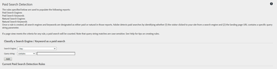

Both Organic and Paid Search are generally going to share the same referring domain... this is why Adobe has the Paid Search Detection settings per suite:
Adobe knows what referrers should be search engines, then you can specify what query parameters are being used on your paid search.
The referrals with the specified parameters will be grouped as "paid search", and everything else as "natural search"
