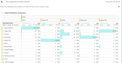

However, I still need to be answerable to my client (Please refer to below screenshot) providing him a justification, ours is an ecommerce client and like for any client, adobe created all marketing channel processing rules in a standard way when initially setting up the account
my client asking me, in which cases data to "NONE" marketing channel is being attributed and we all unable to understand that any purchase order, when we are looking at any attribution it should have an marketing Channel, right ? Even though None will appear only if any criteria of any processing rule doesn't met
when we breakdown the "NONE" with platform, you could also see that most of the orders from "ANDROID" and less amount are from "website", again "Webiste" traffic should be direct as it has no referrer but for app, we are not able to see any referrer value
Can you please help to respond, thank you very much again !

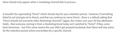

None should only appear when a marketing channel fails to process...
It shouldn't be superseding "Direct" which should stay for your retention period... However, if something failed to set (and got set to None), and that use continue to come Direct... there is a default setting that "Direct should not overwrite other Marketing Channels" (again, this makes sure your 30 Day attribution holds... that someone coming in from a Marketing Email today isn't switched to "Direct" if they come back tomorrow...  but if for some reason the user didn't get properly bucketed, then None will stay active for the retention period unless overwritten by a specific channel.

Not unless you changed the default setting:
Direct and Internal do not overwrite intentionally so as to not break or supersede your specific channels. You can do this, but then it will break the 30 Day attribution model, as every visit will set a channel (i.e. Marketing Email then next visit Direct), and if you aren't careful, you might break the Visit, if you don't always check for the first page in the visit on every rule... but that also can cause issues if the same visit actually has two different specific campaigns (I go to the site via social media [organic], then get an marketing email and follow it... same visit.. two entries... two very different channels...  if you only look at the first page for everything, your marketers would miss the attribution to their promotion).
This is why those other channels do overwrite, as they can be very specific and very real use cases. Which is why you may also want to look at Linear, Participation or Time Decay models, to see cross channel attribution.

I followed your foot steps and used "Marketing Channel Instances" as a metric & I don't see any data being reported to "NONE", how should we look and understand this ?
End of the day, my client explicitly told me that, he should not see these many "ORDERS" attributed to NONE
What is the possible way to solve this ?

Hmm odd... can you just add Orders (without the attribution)... I wonder if those "NONE" were set before your time frame...
Last Touch Orders against Marketing Channel are already "30 Day Attribution" (if you Marketing Channel Expiry is the default 30 Days).. but adding the 30 Day attribution I wonder if you are getting up to 60 Days of Attribution? I think that stacking attributions might be causing some issues...
If I look at my Orders against "Marketing Channel" (which for me has a 7 Day expiry), None accounts for 0... if I add a "Last Touch | 7 Days Orders" on None goes up to almost 100....
Since Marketing Channel is already a Last Touch with built-in Attribution, maybe you should just use Orders without custom attribution...
If you want the First Touch, use the First Touch Channel dimension (this is the default "first touch" attribution of your Marketing Channels...
