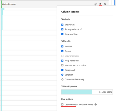

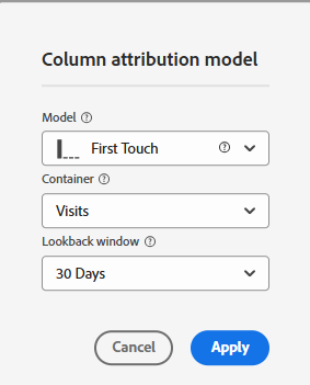

Hi @AmanGupta21,
I agree with @DanIMS1. most likely issue is that the Tracking Code is being overwritten later on in the session. One way which you may be able to get around this is to alter the Attribution for the Revenue/Orders metric:
That should allow Revenue/Orders to be attributed to be first value seen for the visit, which in this case should be the Landing Page Tracking Code. That should work the same for any event you need checking I believe.

Also, tried the attribution modal approach but again no luck.

If you use any other attribution model eg. Linear or Participation, does revenue begin to be attributed?

@EurosIMS said that you could look at "first touch"... (however, this may still cut out LinkedIn campaigns if they weren't the first used in the time frame). I would also suggest looking at "Participation" - this will show you all the campaigns in the specified time frame that contributed to the conversion (weighing all campaigns equally)...  Or you may want to look at other models (Linear will split the attribution, Time Decay will calculate out the weight based on how long ago the campaign was used, etc).  Likely you will see your LinkedIn campaign in these other models that look at the cross attribution.
