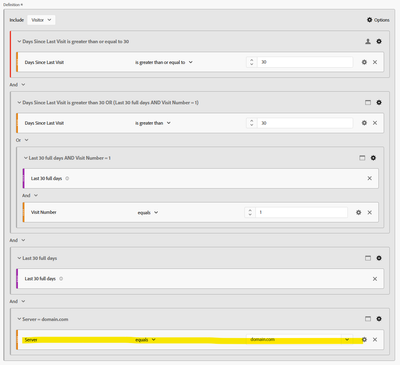

Thanks @Jennifer_Dungan, I follow that its more in relation to the above snippet that i'm curious about, you've shared the following:
EXCLUDE Days Since Last Visit is Greater than or equal to 30
AND
[Days Since Last Visit is Greater than 30]
OR
[Visit Number = 1 & Last 30 Full days]
AND
Last 30 Full days
The text highlighted in red is what I'm curious about, if this a new visit segment how will visits be captured if any visits greater than or equal to 30 days will be excluded.
I also looked into the differences between segment total UV and UV and it could be due the date range that I use:
1. Using Last 30 days there is no difference
2. Using this month with relative date range - This is where differences are observed, and I've done a deep dive; all UV's that are not being captured in the segments sent a hit at 12:00AM on the first of the month, so assuming these are visitors that are on the site from the day before, though they are a relatively small proportion of users, anyway I could capture them in the new visits segment?
Many thanks,
Hanzalah
Ok, so let's start by writing out the full logic of the container (and including line numbers for reference):
New Users (30 Days)
1 VISITOR [
2 EXCLUDE VISITOR container [
3 Days Since Last Visit is less than or equal to 30
4 ]
5 AND
6 HIT container [
7 Days Since Last Visit is greater than 30
8 OR
9 HIT container [
10 Last 30 Full Days
11 AND
12 Visit Number equals 1
13 ]
14 ]
15 AND
16 Last 30 Full Days
17 ]
AND
OR
AND
Last 30 Full days
None of my examples exclude "Days Since Last Visit is Greater than or equal to 30"
They show exclude "Less than or equal to 30"
This is because if the "Days Since Last Visit" is less than 30 then they are Repeat Users (not new), and they will be included in the companion "Repeat Users (30 Days)" segment.
So for this, you basically have people in three buckets:
1. New Users: People who are first time ever, or people who last visited the site more than X days ago
2. Repeat Users: People who came back to the site in under X days
3. There is also a small segment of users that are both first time ever who then come back to the site within the time frame (This group is why there needs to be an exclusion rule on one of the above segments, otherwise these users will appear in both groups, negating the "non-overlapping" requirement)
Bucket 3 is the overlap that would appear in both New and Repeat Users... this is why we need exclusions.
In my examples, I am excluding these overlap users from my New Users, and having them appear in my Repeat Users (since they did come back)... and for us, returning is more important to us.
If you are trying to do the opposite, making sure the "first time visitors" regardless of them returning, are included in the New Users segment, then you need to add the exclusion to the "Repeat Users" segment, and change the logic to exclude the first time visitors.
1. Using Last 30 days there is no difference2. Using this month with relative date range - This is where differences are observed, and I've done a deep dive; all UV's that are not being captured in the segments sent a hit at 12:00AM on the first of the month, so assuming these are visitors that are on the site from the day before, though they are a relatively small proportion of users, anyway I could capture them in the new visits segment?
There shouldn't be any loss if the segments are created correctly... when I did my segments, if I add my "New" and "Repeat" users together, it matches my unsegmented UVs for the same 30 day time frame.
It seems like you may not have matched the segment logic completely from my examples (particularly since you mentioned an exclude that doesn't exist).
Try reviewing your segments in detail and confirm that you have replicated the logic... the slightest deviation can cause issues.
