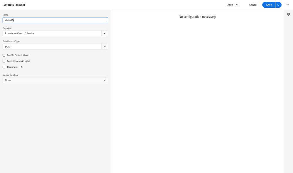

Below are screenshots showing the data element and AA extension setup. I've set it to eVar3 as eVar1 and eVar2 are being used in a global rule for other data elements.
Data Element
Extension Setup
Those screenshots look correct.

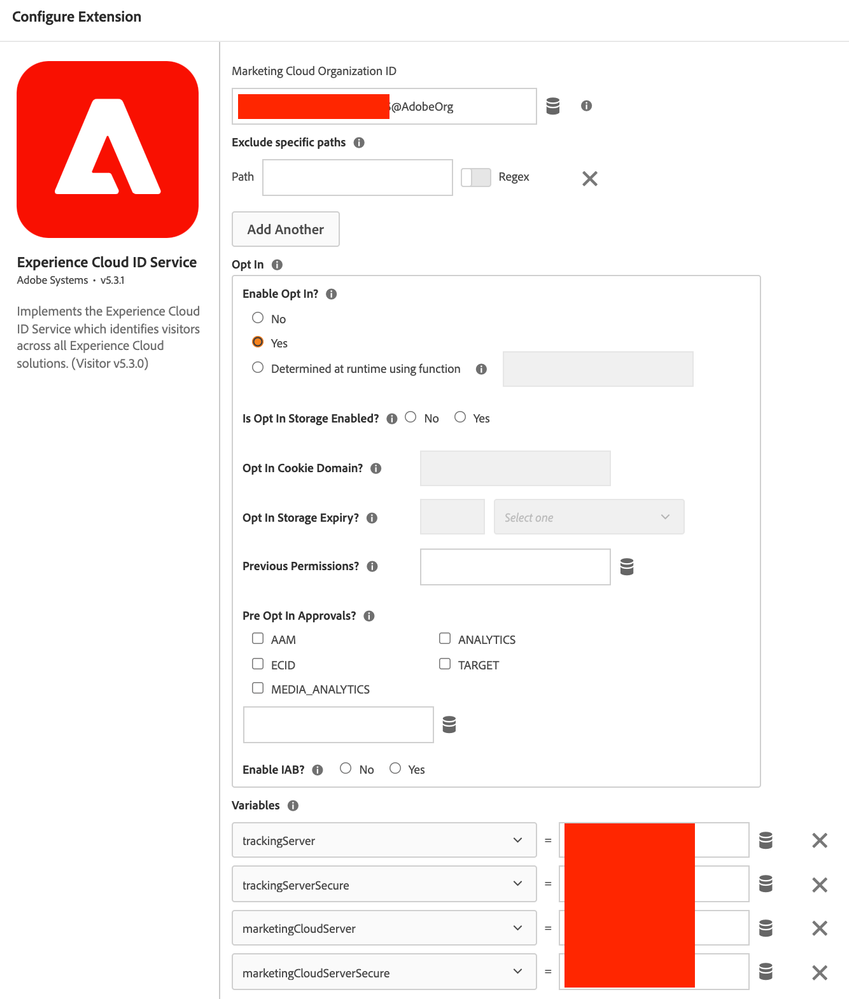

Hi, I'm working with @k_o123 on the same task.
It seems like the issue is that the mid value isn't being set at all, hence why these methods don't work. Can I check whether this is the right setup for the ECID extension?
Oh, you've enabled Opt-in! In that case, the mid value will only get set when the user opts in to tracking. Check Adobe's documentation for configuring this, or you can refer to this blog too: https://webanalyticsfordevelopers.com/2021/02/16/consent-and-launch/
