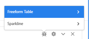

Clicking on that new icon will give you an option for the Table or the Sparkline (choose the Table):
