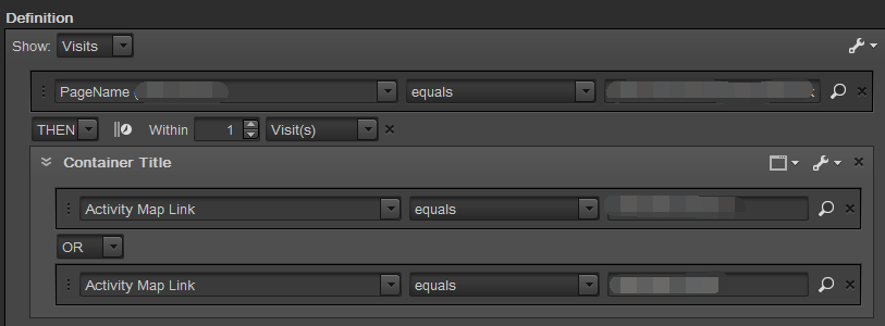

Hello everyone,
Today I would like to ask question about create segment for "within 1 visit".
As you may see, we are evaluating advertisement effects, we would like to know: how many visitors/visits clicked "contact support" when the "current visit" they come to our site.
So I create segment as following:
Pagename is the landing page from paid advertisements.
Sure, I applied another segment which is: Banner Code exits.
For example:
Visit 1: Banner > Landing Page > Page B > Exit
Visit 2: Search > Landing Page > Page B > Click "Contact Support"
Visit 3: Banner > Landing Page > Page C > Click "Contact Support"
Visit 4: Referral > Page C > Click "Contact Support"
Then the total Click will be: 2, and by the segment, I would like to see "1" click since only visit 3 is the one I would like.
However, when the above segment applies, I see very close "click" data, compare with "overall" clicks.
Overall Clicks: 2,446, by segment clicks: 2,389.
It seems not correct to me, since it's not reasonable 98% users click "contact support" at the same visit they come from our paid banners.
Would there anyone could share your ideas and suggestions?
Thanks.
Dear H_L,
You need to drop the condition within Visit Container.
Try it out.
Thank You!
Arun
