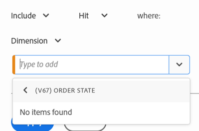

would Order exists be under Order state? I can't seem to find an "order exists" dimension.
Ah sorry about that... the metric is "Orders" the logic is "exists"
You will probably need to use the Segment Builder (as opposed to the Quick Segment Builder" to do the exclusions:
ah great! I just used campaign "does not contain" halloween and it seemed to work! Thank you!
Ah, yes, because your tables are already specific that would work... I wasn't sure if you needed to extend to additional uses, so went with a more specifically crafted segment.
Glad it's working for you 🙂
