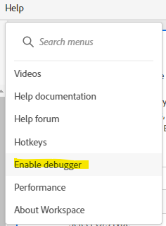

First enable the debugger:

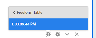

This will add a new icon on your freeform and visualizations:
When you click on this, it will have some options (like table or sparkline), the in the next level you will get timestamps of data pulls:
Click on the timestamp you are interested in, this will open a new window that will include the API calls in use in multiple formats....
You can grab these and modify them to suit your needs.
