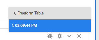

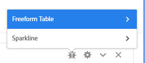

In your workspace, you can enable "debugging"
Once enabled, you will see a new icon on your freeform tables:
Clicking on it will bring up a menu:
Then selecting one of those, will show you timestamps of data pulls.. Select it
A page will open with Information about the API calls used to make your table... in XML, cURL, and JSON
This can help you in how to build out your own API calls
