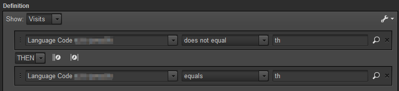

To understand this, I create following 2 segments:
Segment1. At "Hits" Level, Acivity Map Link = Thailand (It's the value of the link if user would like to change the language)
Segment2. At "Visit" Level, "Language Code" does not equal to "TH" THEN "Language Code" equals to "TH".
I assume the 2 counts will be very close, but the result is not.
It seems to me only 44 visits changed the language by clicking the "language" icon and links, other 831 visits changed the language by other ways.
So, I am confused on the reason and doubt the sequential segment2. (I even applied "within 2 hits" in Sequential Segment2, similar result)

now to your segment2: I would do it the same way and would expect to have the right number. and it should not match any patterns "not set"=>"th" because in a prop the "not set" is ignored.
but there might be reasons where the prop receives other values, even the user has still "th" as language? maybe a tracking bug?

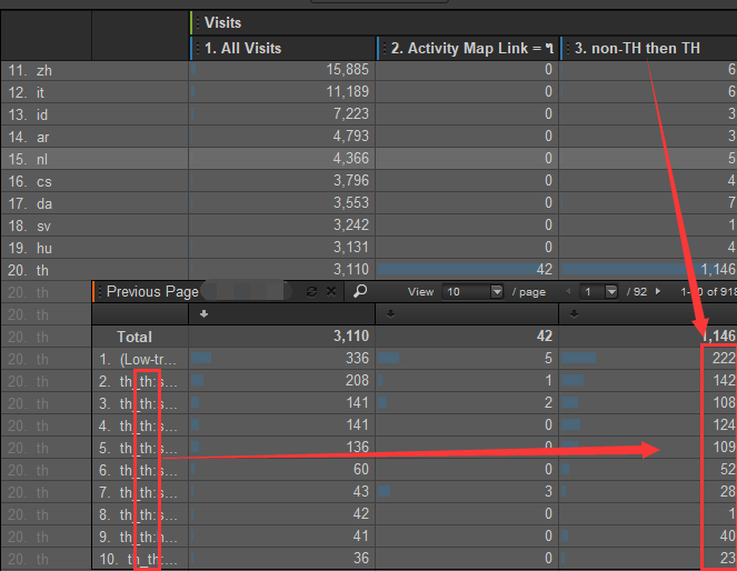

I also tried this way which just came to my mind:
I create another report (right hand side one).
Breakdown "language code (prop)" by "Previous Page" (prop), since we record all "Previous Page" as well.
Then, filter by "none of _th" (format is: countrycode_languagecode)
Then I can find it all Previous page which languagecode is not TH.
I assume that's the counts of change from None-TH to TH.
BUT, the count is only about 500, even I add all "low-traffic", then will be only 800.
But from left-hand side image, there would be over 1000 visits. (segment2 is applied to the counts in red box).
Another problem is:
I even can see counts on non-TH then TH under "Previous Page" with language code:*_th
So I am doubting the correct or not of the segment2
Please share your idea on this.
Thanks.
H
