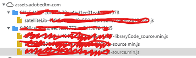

Currently, we have observed that our website has 2 different ".min.js" files under the "assets.adobedtm.com" on our homepage and on our sales funnel pages. However, when we check on the Adobe Experience Debugger, it is just calling the using the same production environment.
Homepage:
Sales Funnel:
Due to this setup, we found out that the changing of Adobe launch embed codes in the Adobe Experience debugger is not working.
We would like to ask your advise on how we can improve this that we may able to change the environments we have on the Adobe Experience Debugger since the DTM switch does not work anymore.

@Jennifer_Dungan just to clarify, you mean that the Adobe Experience Debugger can only like redirect one Adobe launch resource. Thus, since we have multiple on site, only 1 will be redirected. Is my understanding correct?
Also, our Adobe launch has been already installed this way when entered the company I'm not really sure why and how this is setup. Is there are way to consolidate these multiple Launch codes/library/resource?

Thank you so much for your help @Jennifer_Dungan. Will have an assessment on this and will probably continue as suggested.
Just an update on this issue.
Correct me guys if I'm wrong but this is what I have found out and my understanding on the multiple Adobe launch codes on our assets.adobetm.com.
It seems that Adobe has a function when a site is migrating from a DTM to Adobe Launch which allows to just use the old DTM library JS that is already in place on the website pages with the New Launch code library.
When I have compared the contents of the "satellite-Lib" JS file with the one for our Production Environment JS in Adobe Launch, they are just the same.
So one reason why the Adobe Experience Debugger does not work with multiple launch codes on site, is because Adobe Experience Debugger seems to only redirect one Adobe launch resource.
