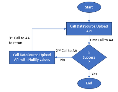

Hi @FrederikWerner ,
Thanks for responding back.
How will I know how many records I need to nullify before uploading same data again? Because exception occurred while uploading data and few records inserted successfully.
Also, to resolve this issue, I need to call API twice, one for to nullify and one for uploading same record again. So, total 3 times I need to call API.
Is my below understanding correct? if yes, Is it right way to handle data duplication?
Hey @sagrawal85,
If you have no log or access to the previous upload it can be challenging to find the faulty uploads. Depending on how you upload data, you could run a report for all data uploaded on a certain day and create an import to nullify all data from that day. Be aware that if you upload negative values without prior positive uploads, you will end up with those negative values in your report. Correcting data like this is a tedious and manual process but it's unfortunately all we have.
The chart you created looks like a good process to me. Be again aware that the 2nd call in the chart should only contain the successfully uploaded rows from the 1st call to avoid negative values in reporting.
