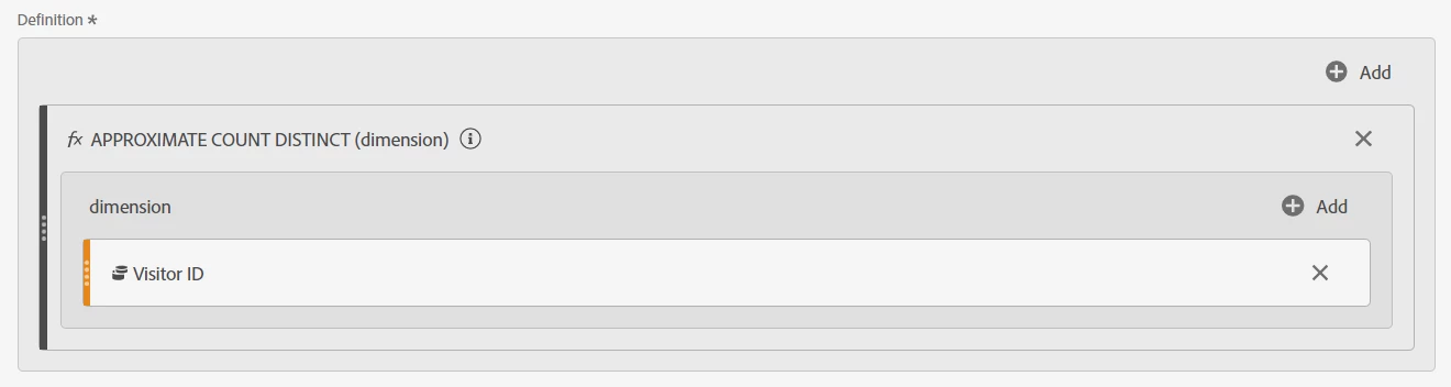

If I was tracking something like a user id in my eVar, I will likely be setting it on every page, because I don't know what page the user will enter my site from, this will mean that every page counts the Instance of... if I want to get a count of unique user ids, I would create calculated metric using "Approximate Count Distinct" function:
