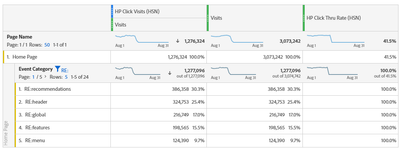

I'm attempting to create a click thru rate calculation for our Home Page team with the calculation created as the below with HP Click Visits defined as a visit with an event category prefix of RE: (our indicator of a link click).
You'll notice that this works great at the Page Name level, but once you do a breakdown on specific link click values, the segmented click visits and the visits become the same.
Is there a way to lock the reference on the breakdown to the total?
So instead of recommendations being 386K click visits / 386K visits and thus always 100%, that it retains the total amount so the calculation would be 386K click visits / 3.0M home page visits.

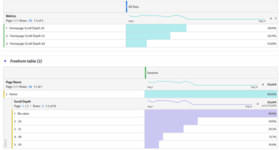

The value next to the Visits is the percentage of sessions (visits) where that item existed on the Homepage. If you click the cog for the metric, & remove the 'Numbers' you'll be left with % value. As far as I can see, that might be all you need?
Based on some numbers I ran, that should match up & give you the correct value? You should even be able to create a metric that's just visits, then re-name it for your report to 'Click-Through Rate'.
As you can see from my chart, the values are identical in both of the first two columns so changing the presentation of the columns won't affect the calculation in the third column. For my third column calculation to work, I essentially need to know the # of times each item was clicked (column 1 row level) divided by total visits to the page (column 2 total level). So basically the second column needs to be the total 3M all the way down.

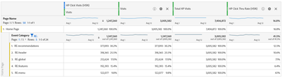

Oh, I think I found a way...
I did a proxy in my own data looking at my home page, and menu clicks.
If you create a custom metric for Visits, where you set it to Grand Total:
This will get you the total Visits... I wasn't sure if this would take the grand total of all pages, but it actually does appear to be constrained by "Home Page"
You should be able to do the math based on that
This is great!
The one problem I have left though is that it now messes up the total row (now over 7M).
I could create two separate tables (one for the total and one for the breakdown), but is there any way to make the Home Page row still say 3M?
Oh, yeah... that will show the "Grand Total of Page Name" (Home Page and all other Page Name)
You can fix this by applying a segment at on the panel (or if there are other things in the panel, you will have to add it to the table spanning all the rows)
Hit [
    Page Name equals Home Page
This will make sure that the only values are "Home Page" so the grand total only includes those hits.
