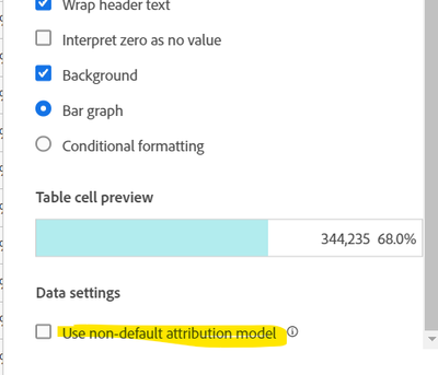

You should be able to apply a custom attribution to the tracking code value that will look at last touch against your conversion metric (I know this doesn't work with some of the standard metrics but it should work with "purchase" or any custom metric you have set up).

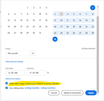

But I think you said that this was only working for the last month... have you tried this model with the new "relative date ranges" feature:
In theory, this should apply the 30 day lookback window based on the selected panel date range.. so you should be able to pull out some data month by month? It's still probably better than trying to export and process it all.....
