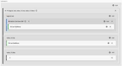

I am working on answering a question about our search results page and I am hoping that there is a calculated metric that can be built to solve this. I have created a metric that can be used to gauge our search relevancy, that is structured as cart additions on our SRP divided by total searches. However, I'd also like to create a binary metric that will return 1 if an user adds to cart from the SRP, and 0 if an user does not add to cart on the SRP.
Is this achievable in the calculated metric builder? Any advice or tips are greatly appreciated!
If you have a dimension or event on your "Add to Cart from SRP" (even using a combination of page with the add to cart event) you should be able to use this with the IF function.
At a basic functionality level, the IF statement can be use to determine if a metric exists in a certain context (like add to cart from SRP)... if true, you can pass either your Add to Cart metric (or you can use a static 1).... and if false, then set a static 0:
So many something like:
