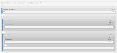

I'm trying to create a calculated metric of "uptake" which is the number of units of luggage (with a segment for luggage) divided by the total number of sectors.
So in the example it would be 34496/80655 which is: 0.42 or like 42%
However, when I do the calculation in the calculated metric it will show 128% which is incorrect.
This is the calculation of sectors:
And this is the calculation of the uptake:
I've heard that this is because the units can also be for other types, so not only luggage but also insurance for example.
Does someone know a workaround for this?

Did you tried creating a separate calculate metric for Total Sectors itself and a new one calculating percentage. This is just my thought. I don't know exactly what the calculation represents. Also, I have a question, why you multiplied WR FO Return with 2. Just give it a try by creating a calculated metric for 'total sectors' and then create another for uptake by dividing units of luggage by total sectors.
