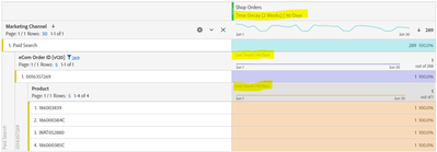

Screenshot1: Default reporting

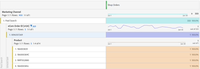

Screenshot2: with same attribution model across dimensions(breakdown) [5th product is not part of the order]

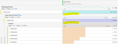

Screenshot3 : with last touch model for breakdown dimensions
If we use last touch model at the breakdown levels, it gives ~1:1 result, however since lookback window is present, is it possible that it still shows few products which do not fall under this particluar order? If that's the case, what would the work around!
