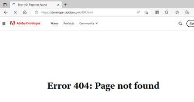

So I go to the next step that says to click authenticate. I do that, it opens a browser, I put in my Adobe login information, but then I get a 404 page. This also means that the excel file is perpetually loading and I eventually have to hit end task to close it. I've been stuck on this issue for a couple weeks. Does anyone know what is happening/how to fix it?

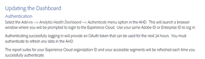

Hi @MandyGeorge , I set this up in our sandbox a few months ago and recall having issues.
I believe I had to use the Many OAuth Token Entry macro.  Have you tried that?  The screenshot below is from bottom of 2nd page of the PDF instructions.
