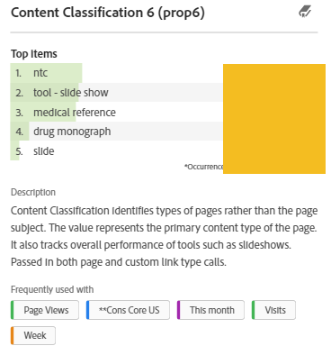

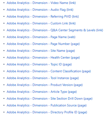

  1. To be able to use the tool, users need to understand the data architecture and what information is available. We created a full library in Confluence that includes every Adobe dimension/metric and every custom dimension/metric/segment. (In addition to our more concise standard data dictionary). The documentation is specific to the use cases of our business. That documentation includes:
    The definition of each dimension/metric/segment
    How it is used to provide insight
    Example report screenshots
    Related Reports/Variables
    How the variable is implemented/configured
    Where the data elements come from in our system
    The format of the values
    Who defines/owns the values?
  2. We use cliff-note versions of the above documents in Adobe’s new, inline version of a data dictionary. This makes the information easily accessible at the point of use.

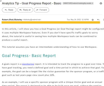

  4. We send out short, weekly tip emails to all AA users on how to use Workspace or how to do analytics. (These are like the Adobe Tips and Tricks sessions at Summit conferences). They are mostly excerpted from our Confluence documents (see above) but include Workspace feature updates as they occur and are relevant.
    Many of these Tips don’t change that much over time. When we get through the list we start over, updating the tip from the last time it was sent. (It also saves time when not creating copy from scratch). There is a lot to know about AA. It takes about 2 years to cycle through our list of tips. Repeating Tips serves both as a reminder and catches new staff.

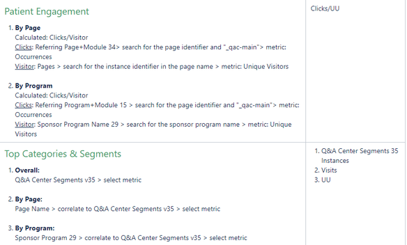

  5. We create product-based metric documents. These include implementation instructions for developers and, important for tool adoption, reporting plans reflecting the business goals for that product. The reporting plan provides specific instructions on how to pull the requested metrics for that specific product.

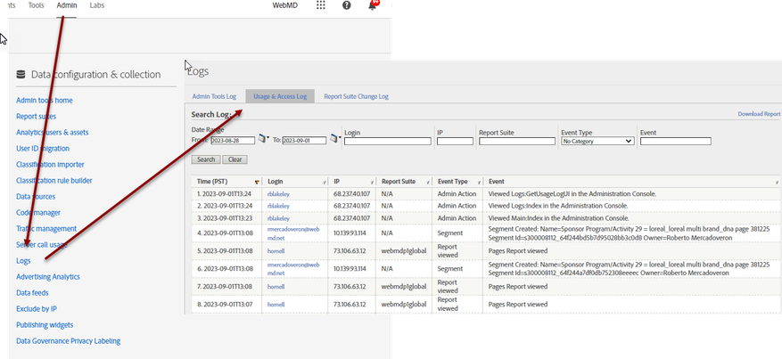

The question comes down to how and how often people are using Adobe Analytics. To answer this, I use the Adobe Analytics Logs. Admin > Logs > Usage and Access Logs.
You can download 3 months of data at a time. For a year’s worth of data, that’s 4 downloads. I then drop the files into a single Excel worksheet.
You can treat Adobe Analytics use just like you would the traffic for any website. For example, you can look for a count of unique users, report views per user, logins per user, frequency, recency, top dashboards viewed, % of users on Workspace vs. Reports, % of total users who pull a report broken down by month, number of reports viewed by day of month, etc. If you know what you are paying for AA, you can calculate Cost/Report View.

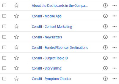

You can get more granular if you have a Workspace naming convention. For example, the work-group I work in names all its business-facing dashboards starting with “ConsBI-“. I can then easily identify these in the logs and see if they are being used.
There is also an API you can use to extract log information (which I have not gotten around to trying). If you are using the API, I’d think you could import that data into an AA report suite and automate that import. Then you could use Workspace to analyze Adobe Analytics usage. Now there’s a thought.
