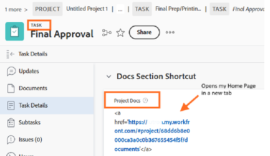

I created a calculated field in a Task Form with the intention of having the user "clicking" on a live link that will take them to the Project's Documents section (if it were to a specific Template Folder even better! but I think that would require Fusion help...)
Although the Project URL displays correctly, the link takes me to my Home Page.
Here is the formula I used:
'   CONCAT("<a href='https://orgname.my.workfront.com/#project/",{projectID},"/documents'</a>")  '
What am I missing...?

I played with this in my instance and got it to work using this code:
CONCAT("https://ORGNAME.my.workfront.com/project/",{projectID},"/documents")
 Let me know if that works for you! 🙂

It did! So close, but yet far.
Thank you, MaddyMa!
