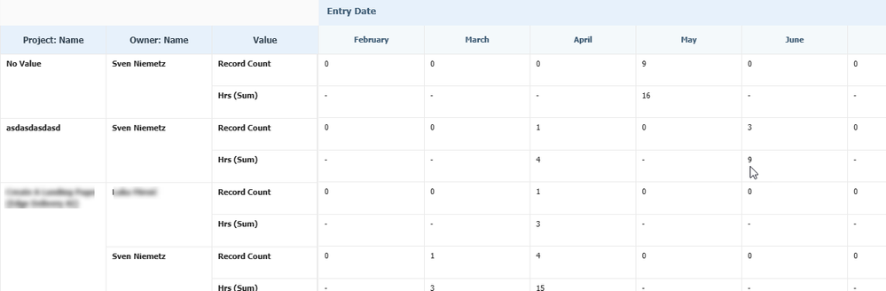

You should use an Hour Report instead. Group the Hour report in Matrix mode by:
Row Grouping: Owner > Name, Project > Name
Column Grouping: Hour > Entry Date (select the summarize by month option).
This might fit the bill - so you can either report on
The latter gives you the sum, see example here
Just saw that you wanted Project first so just switch the two fields in the Row grouping above

I read that as OP asked for "not using matrix"
Your report thought gives exactly what OP described, neat!
