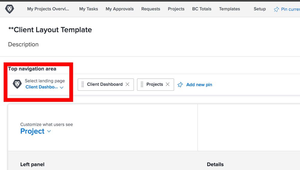

How do you change the landing page when someone logs in, in the New Workfront Experience -- in the Layout Template? I can't find the option anywhere. Thanks!
4 Replies
@Jill Ackerman‚ Yes it's in the layout template on the top left on a little dropdown. So if you have multiple layout templates you'd need to set each one.
That drop down changes where it lands when I click on the logo, not where it opens when I first login. No matter what I select for that area, the logo url changes but I always open up to Reports. Or perhaps my layout template has a problem and I need to contact support, which I will do now.

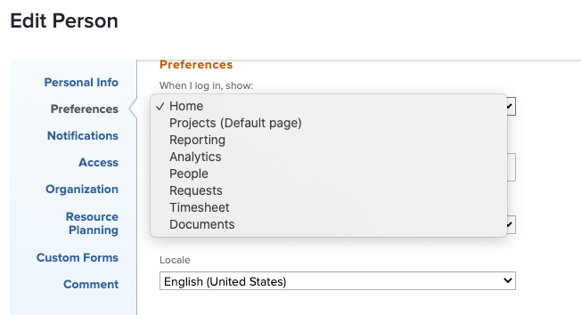

Hi Jill,
Look under "Edit Person"
So this turns out to be more nuanced than this and I'm trying to get to the bottom of it. Editing the Person is there, but according to Support, what you setup for the Home button overrides Edit the Person (that actually makes no sense to me in any way, but that's what I was told yesterday -- it's possible they reverse this as I have challenged the logic of such a thing but we'll see about that).
