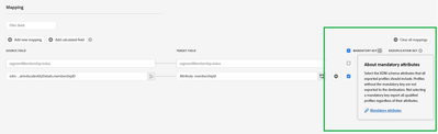

This may be because of "Mandatory Key" - profiles without mandatory keys wont be exported if you choose this option.
I dont think its causing because of deduplication, here only the duplicate profile will be excluded, otherwise all unique profile will be here.
Refer this below screen shot,
I suspect the way you activated may different for both these destination, please check this and confirm.
