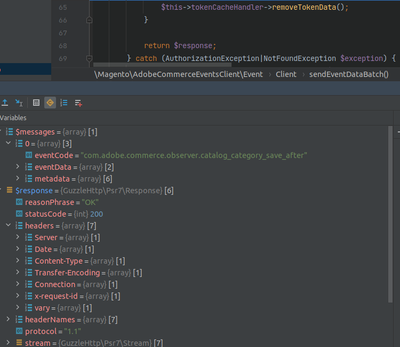

5) xDebug receives a response that the event was sent successfully.

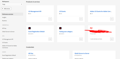

6) But it doesn't come to my microservice and I can't get it in the Event Browser tab.

Hi @Eugene_Kapelko, Can you please share the event registration URL from developer console? I noticed you have masked out those details but having the URL would be helpful for us to debug.
