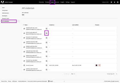

  3. Assign product profiles -
    1. A system admin needs to go to the Admin Console. Go to Users > API credentials
    2. Find the tech account ID from step 1 in that list and click on the magnifying glass icon for the tech account.

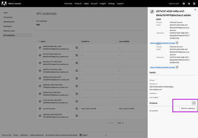

    3. Click the three-dot overflow menu next to products. Click on Edit API credential
    4. Once the modal opens, click on the + sign and assign all the product profiles from step 2.
Admin Console > Users > API credentialsAdmin Console > Users > API credentialsView details > Edit API credentialsView details > Edit API credentials
