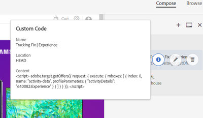

I've added it as a custom code snippet to the control and the experience (see experience below) in the AB test where i made the content changes, I'm tracking engagement with the elements changed (link clicks) in this AB.

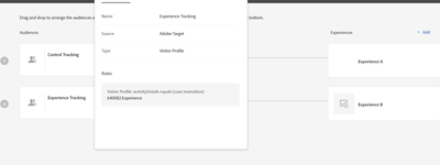

I then setup an XT targeting the same url and i created an audience using the profile parameter passed in the other activity - and on this activity i setup the goal to measure orders in my other reporting suite:
Does this look about right?  Just want to make sure i've got the setup correct.  I've tested it but my analytics isn't showing anything yet so i'm not sure if it's a report delay or if i've done it incorrectly...
Mycal
That does look correct to me, did you see the data in analytics?
